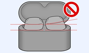

- Check that the earbuds are placed properly in the charging case. If they are floating, they may not charge properly.
Please note that if you use ear tips other than the included ones, they may not fit properly in the charging case.
