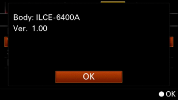

Check the System Software Version of Your Camera
Follow the instructions below to check the system software version:
  1. Select MenuSetup7Version.
  2. The system software version is displayed.
Notes:
  • If the system software version is Ver. 1.01, the update is not required.

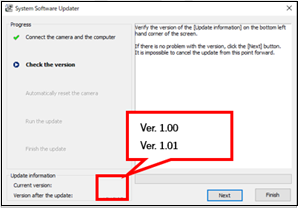

  6. After confirming that the current software version is Ver. 1.00, click Next. If the current system software version is Ver. 1.01, the update is not required. In this case, follow the steps below:
    1. Disconnect the camera from the computer.
    2. Click Finish.
    3. Turn off the camera.
    4. Remove the battery pack.
    5. Reinsert the battery pack.
    6. Turn the camera back on.

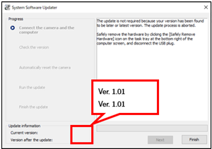

    • System Software Updater screen displayed when the update is required:
      The [Current Version] on the lower left of the screen is showing 1.00 or earlier, and the [Version after the update] is showing 1.01.
    • System Software Updater screen displayed when the update is not required:
      The [Current version] and [Version after the update] are displayed as 1.01 at the bottom left of the screen.
