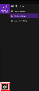

    • If the installed INZONE Hub application is not up-to-date, a red circle will appear on the gear in the lower left corner. Click on the gear icon to go to the settings screen and click Update to update the INZONE Hub application.

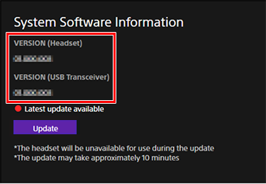

  3. If an update is applicable, a red circle will appear in the Device settings. Before updating, please confirm that the Bluetooth function is OFF in the red frame.
  4. In the System Software Information screen, select the Device Settings and press the Update button.
  5. A confirmation screen for executing the update will appear. After confirming the update details, click the Update Now button to start the update. Once the update starts, the headset will not be available until the update is complete.
  6. When the update starts, you will see the System Software Update screen. Please wait until the update is complete. The System software update may take approximately 10 minutes.
  7. When the software update is completed, press OK.
  8. Check the software version by following Check the Firmware Version of this document. If both VERSION (Headset) and VERSION (USB Transceiver) are indicated as 01.001.000, the update succeeded.
