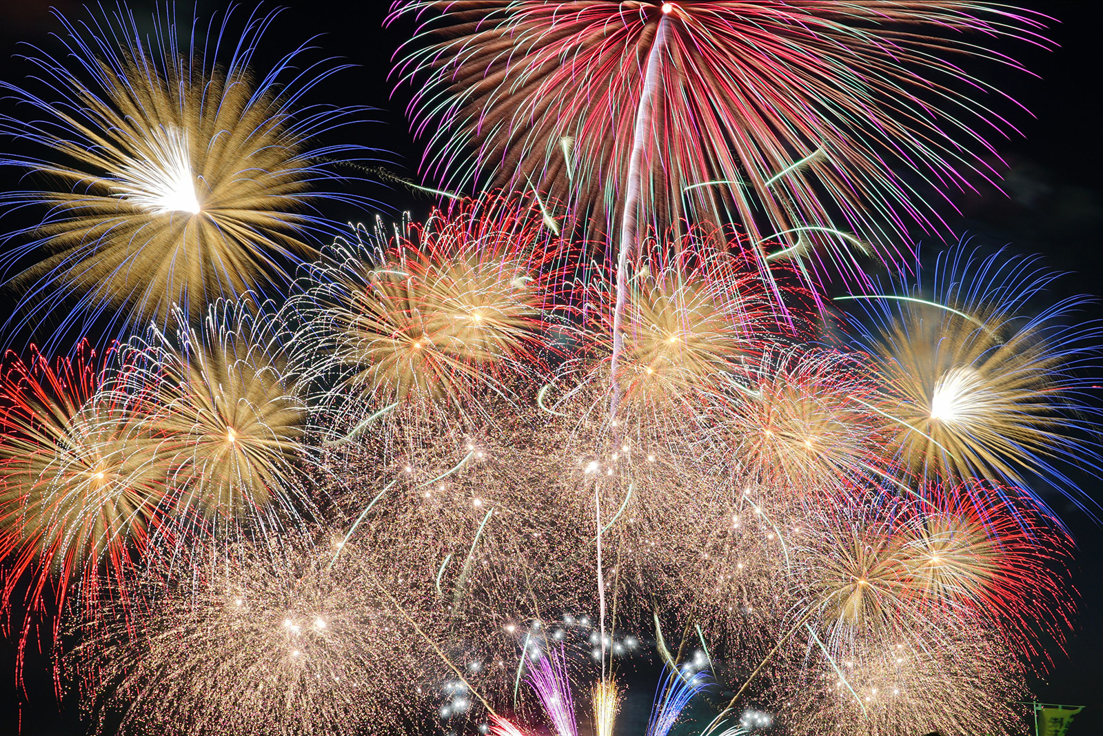

    LESSON 15Photographing a Fireworks Display
    Photograph
    Focal length: 28 mm, f-stop: 14, Shutter speed: 23 seconds.
    Summer is the season for fireworks. With a camera, you can capture captivating images of them lighting up the night sky for brilliant, fleeting moments. Are you ready to try photographing at least a few this summer?

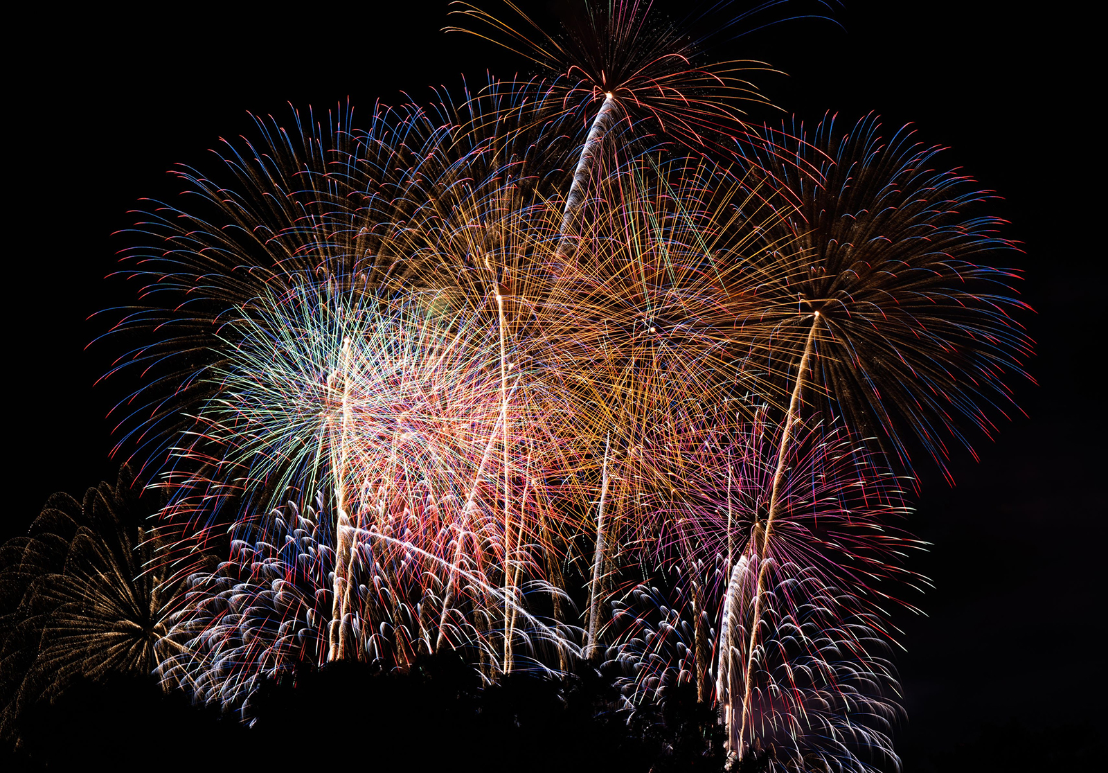

    While keeping the shutter open throughout the duration of a continuous series of firework bursts can create a gorgeous image, the light of various fireworks can overlap at same positions, creating an image containing white, overexposed areas.
    Photograph
    Multiple firework bursts overlapped.

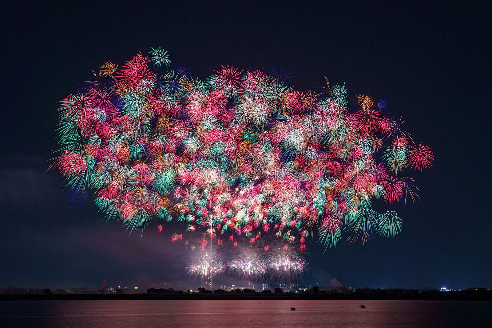

    Photograph
    Focal length: 62 mm / F-number: 14 / Shutter speed: 52 sec.
