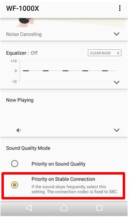

    How to set the sound quality mode using the dedicated app Headphones Connect:
    *WF-1000X is used as an example.
    1. Install the app Headphones Connect on your smartphone.
    2. Connect the headset to your smartphone, then start Headphones Connect and change the settings
